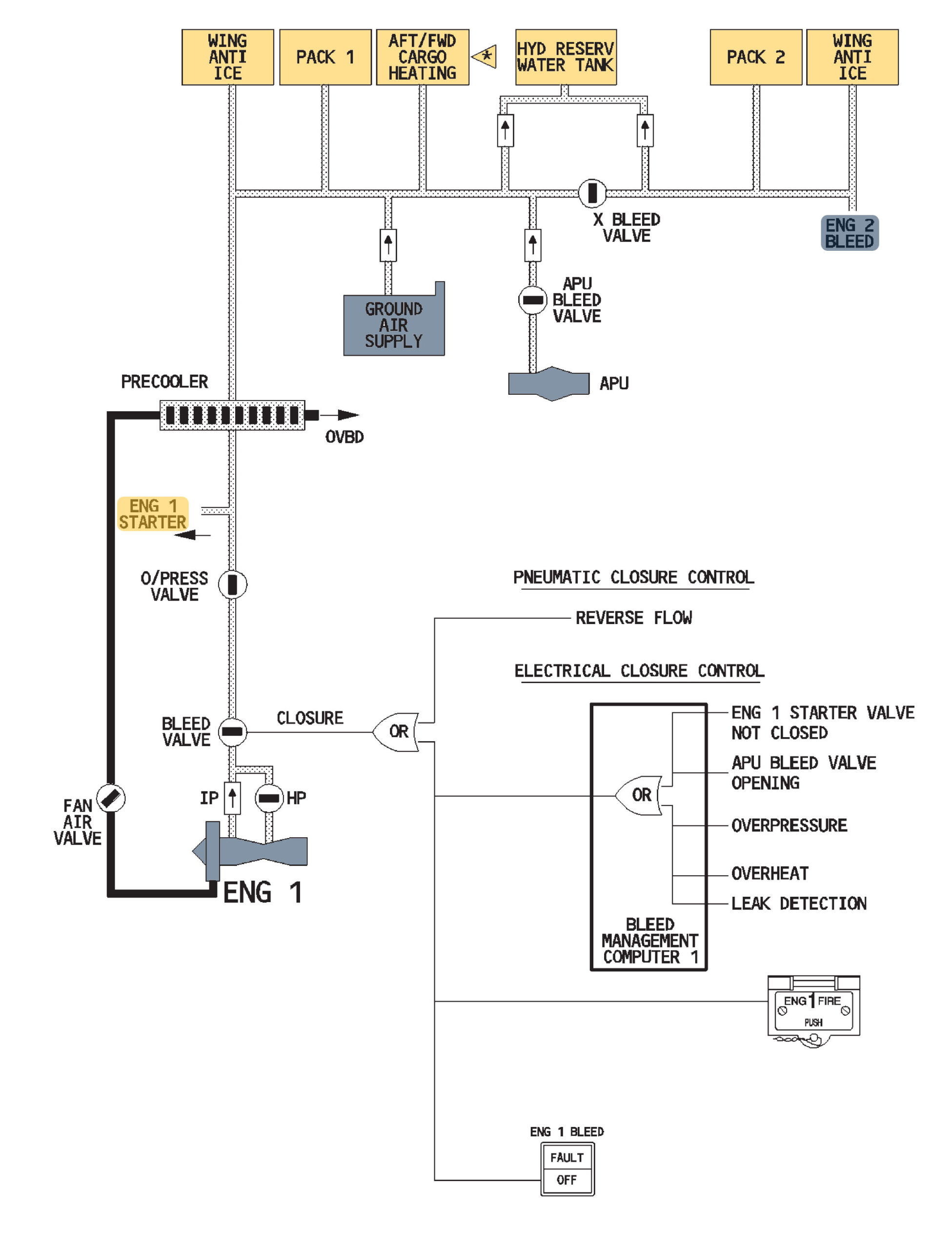

Many aircraft systems rely on bleed air, extracted from the compressor stages of a gas turbine engine. Alternative sources include engine-driven compressors, blowers, APU bleed air, and ground power units. Since system designs vary between aircraft, detailed knowledge is unnecessary.
A320 Pneumatic System Diagram: Bleed air sources are highlighted in blue, and bleed air users are highlighted in yellow.
