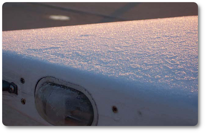

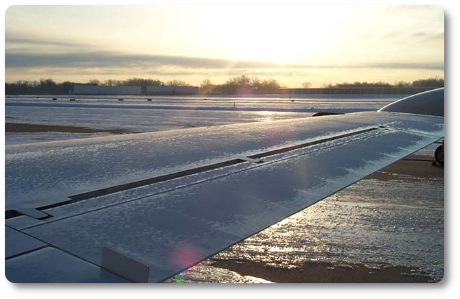

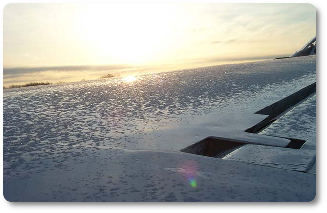

Hoar frost appears as a thin, uniform deposit of ice with a fine, white, crystalline texture. It will need to be removed prior to flight, but will not reform.
Manufacturers often publish guidelines with respect to an acceptable amount of frost for takeoff when it is confined to the lower wing surface within the fuel tank area. However such guidance is typically reserved for larger transport category aircraft. Always consult the aircraft flight manual or pilot operating handbook regarding an aircraft’s ability to operate within icing conditions.
Typical hoar frost found on aircraft in the morning
