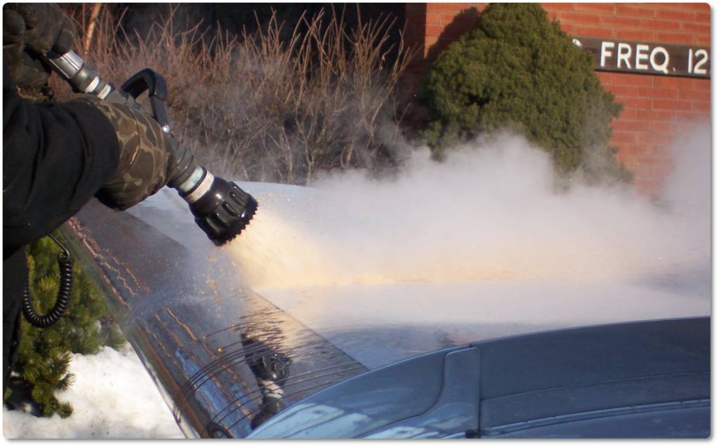

These fluids in the concentrated form contain a minimum of 80% glycol and are considered “unthickened” because of their relatively low viscosity. These fluids are used for de-icing or anti-icing but provide very limited anti-icing protection. Type I fluids are always applied heated and diluted. De-icing is primarily achieved through heat and hydraulic force. Anti-icing is achieved primarily by the heat imparted to the airframe.
